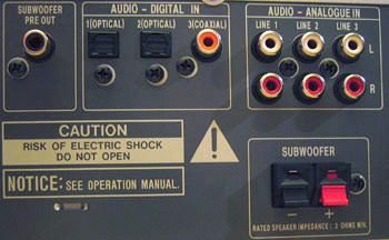

For an inexpensive one-piece surround system, the SD-SP10 is pretty flexible. It includes one coax and two fiberoptic digital inputs plus three analog stereo (RCA) inputs. So you can hook up a DVD player, a digital cable box or OTA tuner, a VCR and an iPod and still have room for two more sources. Each of the digital inputs has its own input selection button on the remote which allows the unit to work well with external programmable remotes such as a Logitech Harmony or Home Theater Master unit. To access the analog inputs you cycle through the 3 options using the "line" button on the remote.
For a $350 two-piece surround system, the SD-SP10 has a surprising amount of inputs and outputs.
