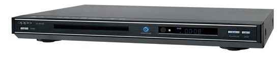

This Thing Plays (Almost) Everything
In addition to standard DVDs and CDs, the OPPO player supports playback of DivX and Xvid-encoded AVI files, WMA, MP3, and JPEG file (stored on a data CD or DVD), and Kodak PictureCDs, as well as native playback of DVD-Audio and SACD discs. Unlike many other SACD or DVD-Audio players, the OPPO supports digital output of the DVD-Audio or SACD audio track via HDMI, so you won't need to wire this puppy up to your receiver with 6 unwieldy analog RCA cables just to get your multi-channel music on. For DVD-Audio, the player simply expands the MLP (Meridian Lossless Packets) audio to its underlying PCM track and passes that over the wire to a compatible receiver or processor. For SACD, it converts the native DSD audio track to multi-channel PCM as well. Because the player uses PCM, you'll be able to decode these signals with any HDMI 1.1-compliant receiver with on-board multi-channel PCM decoding.

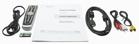

The OPPO player comes with everything you need to get started, including an HDMI cable.

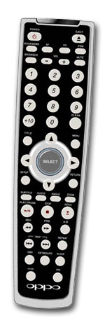

The OPPO's remote is functional but not exceptional.
Remotely Challenged
The DV-981HD's remote control is nothing special. It includes glow keys but no backlighting, nor is it that easy to tell the difference between buttons by feel. The layout is reasonably intuitive, so you'll be able to get used to it, to feel your way around the frequently used controls. But if you have a universal remote like a Logitech Harmony, Monster or Universal Electronics model, your best bet is to get the functions of the OPPO in there right away and stick this remote in a drawer somewhere. You won't miss it.

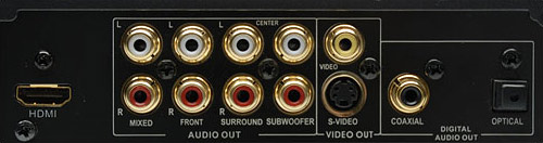

To take advantage of the DV-981HD's upconversion circuitry and advanced digital output, you'll need to opt for the HDMI output.
