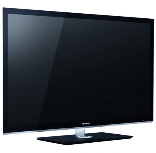

If you're one of the many consumers looking for a large, svelte flat-screen to hang on your wall, Toshiba's LED edge-lit 55WX800U is one of the thinnest and most attractive displays we've seen. Measuring just a hair over one inch thick (one inch!), this chrome-trimmed beauty is guaranteed to score high with the aesthetically-minded in your household. (I didn't say women. Not overtly at least.) On top of its stunning good looks, the 55WX800U is also a 3D-capable display, when paired with Toshiba's active shutter 3D glasses. Although the display is far from perfect, TV shoppers looking for a slim and sexy, 3D-ready display would be well-advised to read on.
The Walk Around
As mentioned above, Toshiba's 55WX800U is one THIN display. Said another way, it's flat-out gorgeous, with "flat" being the operative word. Thanks to its edge-lit design, this Toshiba measures only 1.15 inches thick, giving it a ridiculously slim profile when paired with a flush or recessed wall mount. Rounding out the package, chrome trim adorning the sides of the all-black bezel and touch-sensitive controls makes for a winning combination.

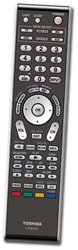

The remote control Toshiba supplies with the 55WX800U is quite the chunky monkey. It's larger than most, heavier than most, and will likely be a bit cumbersome for the dainty hands crowd. That said, my large hands liked this remote quite a bit. For starters, it's fully backlit. The cursor pad area, which features the controls you're apt to use most often, is excellent, with a good layout and welcome spacing between the rocker pad and its surrounding buttons. The RETURN button is the only button that could benefit from a relocation, but aside from that it's all good.

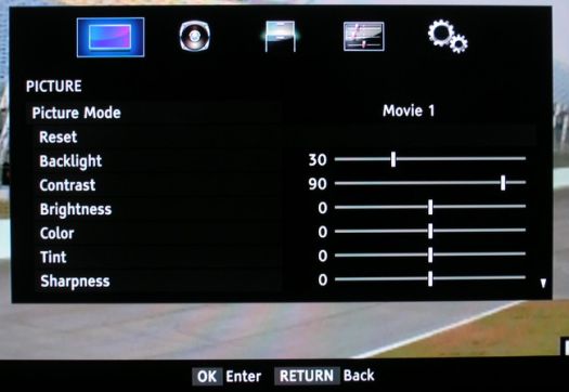

Toshiba's on-screen menu system is simple, elegant, and fast. It's not fancy, it's not loaded with color, but it is intuitive, easy to use, and it gets the job done. Video adjustments can be made without the full menu cluttering up the screen, and Toshiba gives you a fairly robust array of these adjustments in both the "Advanced Picture Settings" and "Expert Picture Settings" - though "Test Patterns" would be a better label for the latter.

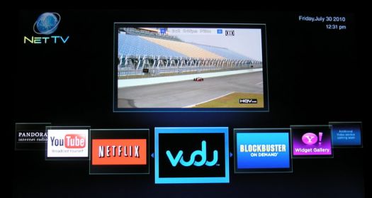

"Net TV" is the name Toshiba has given to its its suite of internet applications and streaming content options, which at the moment includes Netflix, VUDU, YouTube, and Yahoo TV Widgets (which in turn gets you Pandora and numerous others). If I had to use one word to describe the Toshiba's NetTV interface, that word would be "quirky" - though "moody" and "unpredictable" are close runners-up.
There were numerous occasions during my time with the 55WX800U that the NetTV and Yahoo Widgets buttons on the remote stopped working. On these occasions, the buttons failed to launch the NetTV and Yahoo Widgets interfaces, respectively. Other times, the NetTV button wouldn't work, but the Yahoo Widgets would. And if you the clicked on the NetTV widget icon FROM the Yahoo Widgets bar, NetTV would launch successfully. Mind you, there were also plenty of times NetTV behaved as expected. But I do believe NetTV still has a few gremlins which I'm hoping a future software update can eradicate.

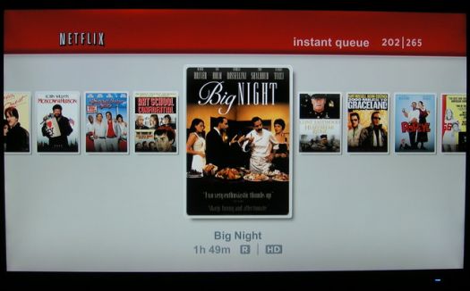

Netflix streaming, sure to be the most popular of the app bunch, is unfortunately the first generation of the interface - most common on 2010 model year TVs and Blu-ray players. That means you cannot search for movies by title and you are effectively limited to watching that which is already listed in your Instant Queue. Based on what I've heard from other manufacturers, it is unlikely this will evolve over time on current models. It is what it is. That said, managing your queue from Netflix.com is hardly a major chore. All it takes is a web-enabled PC, Mac or smart phone and a few clicks of a mouse (or a few taps on a touch screen, as the case may be)
In addition to the aforementioned apps Toshiba gives you, there is also an icon for Netflix's nemesis: Blockbuster On Demand. However, when you click it, it tells you this service is coming soon. It's possible we'll hear more about this at the Consumer Electronics Show later this week, so stay tuned. [it's also possible no one cares much about Blockbuster - ed.]

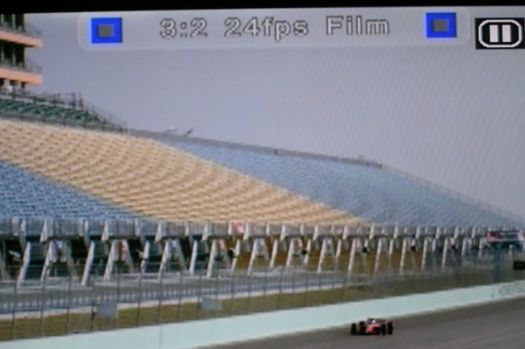

After a quick trip through the video settings menus turning off all of the usual suspects (noise reduction, dynamic contrast, ambient light sensor, etc.) I popped in the DVD edition of IDT's HQV Benchmark 2.0 using my Oppo DVD player connected via component video using 480i output. Most of the tests passed just fine, with minor stair-stepping visible on the flag and relatively minor ripples on the oscillating bars. However, one test proved rather troublesome and that was the 3:2 film cadence detection clip in the disc's "Film Resolution" test.
After repeated tests and lots of trial and error, I discovered that the only way to get the 55WX800U to properly detect and handle 3:2 film cadence is to engage the "Film Stabilization" feature, which has three settings: Standard, Middle, and High. Unfortunately, this feature - working in tandem with Toshiba's "ClearFrame 240" anti-blur technology - gives film that unnatural look of video or a daytime soap opera. The "Standard" setting is rather subtle in this regard, but it was rather disappointing to see that 3:2 cadence could not be properly handled without this feature engaged. (Note: It is possible to subsequently turn off ClearFrame 240, but it gets engaged by default whenever you turn on Film Stabilization.)

A quick color calibration yielded solid results with respect to color accuracy and grayscale. The latter was quite good in fact, with black-to-white ramp patterns yielding a nice, consistent gradient with no discernible color push. This manifested in excellent skin tones during real world viewing material such as Will Smith's I Am Legend on Blu-ray. Smith's red Mustang popped magnificently against the overgrown grime of NYC and shadow detail inside the car was respectable with an above average depth of black.

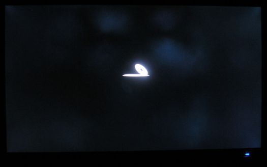

The opening minutes of The Dark Knight Blu-ray also looked great with respect to fine detail and color, but when the IMAX-filmed opening ended, I did find my eyes occasionally drifting to the four corners of the display. The black bars framing the 2.35:1 content showed noticeable light bleed at the four corners, and there were also spots toward the center of the screen that I can only describe as light "blotches." This uneven brightness is undoubtedly the result of the Toshiba's edge-lit approach to its LED backlighting.
Unfortunately, this is not an issue you can easily mitigate through calibration. Edge-lit LED TVs must pay a price for their slim profiles, and very often that price is uneven brightness when it comes to black level. This is also known as "uniformity" as the lighting of these edge-lit sets lacks the uniform brightness you would see on a self-emissive technology such as a plasma. For some, this is a major issue, but you really have to see if for yourself before considering it a deal breaker. For example: if I didn't point it out to my wife, it's doubtful she would have ever noticed it on her own. During regular TV viewing, it's not something you generally see. But put on a movie with good dark scenes and you are more likely to notice it.
