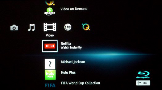

The interface is Sony's well known Xross Media Bar (XMB), as seen on the PSP, PS3, and pretty much every other Sony product lately. Personally, I love it. It's easy to navigate, looks good, and did I mention easy to navigate? Everything after that last point is a distant second in my book.
Navigating over to the Internet Video tab, you'll see an nearly endless list of options. The big ones, Netflix, Amazon Video on Demand, Hulu Plus and YouTube are all here. There's also content from Epicurious (a decent recipe site), Wired, Style.com along with Sony concerts, trailers, and their Qriocity service.

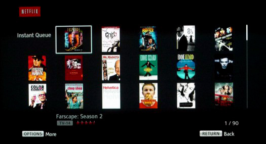

The overall Netflix interface is aesthetically similar to the new PS3 Netflix interface, with cover art 6x3 across the screen. Unlike the PS3 and the Apple TV, there is no way to search to find new content. You need to log into Netflix from a web browser to add titles to your Instant Queue, which then show up on the BDP-S470. This is the case with pretty much every Blu-ray player, unfortunately. Thankfully there doesn't seem to be any trace of the chroma upsampling error (the so-called Chroma Bug) like what we found with the Panasonic Blu-ray 3D player. Overall Netflix video quality is average. Not quite as sharp as some other devices, but not as soft or as noisy as others.
