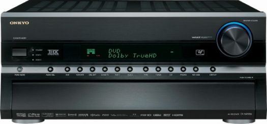

What's It Got? When searching for an AV receiver, most people look first for power, then for inputs. The rest, as they say, is just gravy. On the other hand, for me at least, it's the gravy that makes the dish, and in this case, the gravy is excellent. Onkyo's 7.1 channel, three-zone TX-NR906 sits at the top of the company's current line of A/V receivers. The front is covered with more logos than a NASCAR auto (they're subtlety placed at the bottom) indicating that this receiver can tackle every format known to home theater, including of course on-board decoding for the newer Dolby and DTS codecs found on Blu-ray discs (Dolby Digital Plus, Dolby TrueHD, DTS-HD Master Audio and DTS-HD High Resolution Audio). Also identifying this as a five-star dish is the THX Ultra2 Plus rating which includes THX's new Loudness Plus technology, which is supposed to make your movies sound reference-perfect even when you're not listening at studio reference volume level.
Aside from decoding just about everything, the TX-NR906 is an excellent hub that takes in all your sources, sorts them out for easy access, then sends them out to your TV and speakers shiny and clean like they've just been through a car wash. On the video switching side, you get the expected assortment of analog (s-video, composite, component) inputs for legacy equipment, plus four HDMI inputs and 2 HDMI outputs. Video gets spiced up with Silicon Optix's HQV Reon-VX processing that handles resolution upscaling to 1080p from any video source. It also includes Image Science Foundation Certified Calibration Controls (ISFccc) support for professionals (or daring amateurs) to tweak every facet of the picture and store these settings per input, just as Dr. Silver (Joel, to his friends) recommends.
On the audio side, the TX-NR906 is a 7.1, 145 watt-per-channel, 54-pound, aural monster. The list of audio components on this product reads like a space shuttle shopping list: toroidal and independent power supplies, Texas Instruments Aureus 32-bit DSP chips, Burr-Brown PCM 1796 DACs, Vector Linear Shaping Circuitry, inverted Darlington circuit ... what that all means is this receiver can handle The Dark Knight without a bump. Onkyo claims it's designed for rooms up to 3,000 cubic feet. My own home theater room measures 2,100 cubic feet, which seemed to fit this system just fine.

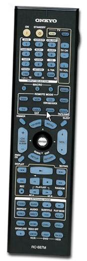

Getting a complex unit like this working could have been daunting, if Onkyo hadn't made set up so easy. My review unit didn't come with a manual (probably lost in the multiple packing and repacking that review equipment often goes through), so I decided to just dive in to see how far I could get before I felt the need to download a PDF manual. First, the remote is, well, average. The buttons are adequately sized and labeled and there's a joystick in the center that responds well, but it's not the kind of remote that screams "flagship" to me. The backlight is a dim green and there's no LCD display to tell you what mode you're in. Also the IR beam isn't strong enough to bounce off a back wall or ceiling (I can do that with my Logitech Harmony remote).

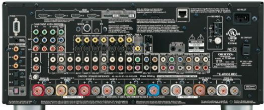

The rear jack pack, while full of every conceivable port you could want (including phono for vinyl fans), has enough finger room to allow you to get the speaker wires screwed in tight without cursing. Once all the ins and outs were hooked up, I hit the setup button to see where that took me. The setup menu allows a good deal of customization on both the audio and video fronts, but it's easy to navigate. I quickly renamed the inputs, set up the output resolution and moved onto stage two.
