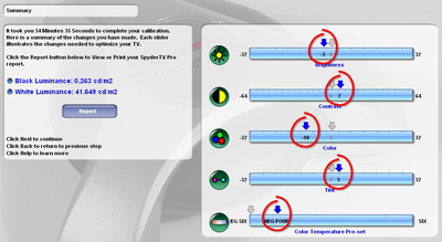

Yes, I've used that "Spyder, man" joke before, but it seemed a propos here. I calibrated the projector via both the Avia DVD and SpyderTV Pro and, unlike my experience with the 100U, I found Spyder gave the purest result. This is likely due to the fact that Spyder sets the Color Temperature while Avia did not.
With Spyder, I ended up decreasing Brightness to -3 and increasing Contrast to 7. Color was brought down to -10 while Tint went up to 3. But I think it was the bringing the Color Temperature to -4 that helped achieve an overall warmer tone. Flesh tones in particular looked much more realistic post-calibration.

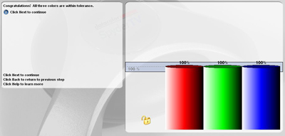

Spyder's Report Card
With a few minor adjustments to the RGB Cuts and Gains (remember, Cuts=Brightness and Gains=Contrast), we were able to get the RGB levels at 100% across the board and we were ready to go.
A Perfect Score!

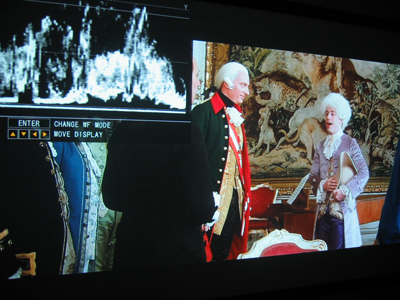

Riding the Wave(form)s
The award for Coolest-Feature-That-I-Don't-Completely-Get-The-Use-Of goes to the Waveform Monitor which, according to the manual, monitors the "luminance levels of the input signal." I'm sure it does, but all I could think of was "micro-changes in air density" from "Alien."
Wolfgang's Waveform

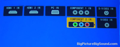

Another favorite feature of mine was the input selector that appears in the top right corner of the screen when you select inputs. Somehow it makes switching inputs fun!
Input Selection Can Be Fun!

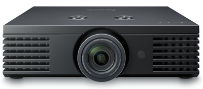

From an esthetic standpoint, the 1000U is no iPod. Obviously, at 5.1 x 18.1 x 11.8 inches (HxWxD) and 15.9 lbs it's a biggie, and its black finish is industrial without being ugly. The casing has two dials for lens shift and a nifty side panel which opens for zoom and focus. Other than that, this isn't a projector you're going to be showing off to your friends. But their eyes will be fixated firmly on the screen, trust me.
And what are YOU starin at?
