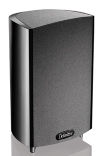

The ProMonitor 600 comes with removable feet as well as keyhole and threaded mounts for installation flexibility.
And speaking of flexibility, the satellite speakers themselves offer very flexible mounting options. An integrated base on each satellite allows the speakers to stand on their own on a bookshelf or media center, but this base is removable for wall-mounting via one of the threaded mounting holes or the simple keyhole mount that appears on the rear of each speaker. Also the speakers' low profile design allows you to place them discretely in virtually any location. I mounted the front speakers on small stands, the center speaker in an entertainment center and the surround speakers toward the rear of the side walls using their keyhole mounts.

ProMonitor 600
  • Dimensions: 7" H x 4-1/4" D x 4" W.
  • Frequency Response: 65 Hz – 30 kHz.
  • Driver Complement: One 3-1/4" bass/ midrange driver coupled to one 3-1/4" pressure-driven planar low-frequency radiator. One 1" pure aluminum dome tweeter.
  • Rec. Assoc. Ampl.: 10 – 150 watts/channel.
