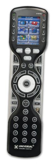

With its bright colorful LCD screen on top, and logically laid out hard buttons below, the URC Digital R50 looks like it means business. But what sets this little guy apart from similar remotes from Logitech and others is that the R50 doesn't need an internet connection, nor even a computer, in order to get it configured - it comes with all the device codes you need built in (at least in theory).
I decided to run the R50 through its paces in my primary review system. With over a dozen devices, many of which are new models, I thought this would give the R50's built in code database a run for its money. The R50 can store up to 18 devices in its beefy on-board memory so it was certainly up to the task. And even in this challenging set-up, the remote did pretty well.
Unlike some of the more expensive Logitech remotes, the URC Digital R50 lacks a charging station and rechargeable batteries.  But considering the problems Logitech has had with these charging base stations, I'm glad the URC remote works with standard AA batteries instead.  Just buy yourself four (or eight) good hybrid rechargeable NiMH batteries and a good AA charger and you'll be in business.
I had resolved to not consult the owner's manual for this review, and I made it pretty far along without doing so. I almost got stuck when I took an extended break during the configuration. With several devices to add, it was unlikely that I would have an uninterrupted stretch of 30-45 minutes to configure the remote. When I returned to resume set-up, the set-up screen was gone, replaced by the main screen that an end-user would see after the remote is completely set up. But it took me less than a minute to try holding in that big fat "Main" button for a few seconds, and sure enough, this took me right back into the set-up screens.
Instead of asking you to enter the make and model number of your devices, the R50 asks only for the type of device (hint, Blu-ray players are in the "DVD" category) and the brand of the device, then it begins cycling through codes that it believes will be a best fit for each component. When you get to a code set that successfully turns off your device, you hit the "test" button to test a few more functions, then you can either save the code or keep moving on to one that might be a better fit.
The routine worked pretty well for most of my components, except for a Cables-To-Go (Impact Acoustics) HDMI switch which I could not find listed in any of the expected categories. Fortunately, the R50 also allows you to learn commands from an existing factory remote control if the R50's code database comes up empty. Teaching the R50 the power on/off and input buttons of this device should have been a simple affair, pressing the desired button on the R50 followed by the corresponding button on the original remote. But unfortunately, the first time through, only about half of the buttons were successfully learned. It took four attempts for the R50 to finally learn the "Power On" function from the switch's remote. But once that was done, the R50 could successfully control all operations of the HDMI switch.
On the devices that the R50 did find in its database, I found the button layout pretty intuitive, mapping to similar functions on the device without the need for additional customization. And the functions that had no corresponding hard button (like the ever-popular "DVR" button on a DISH Network DVR, which brings up the list of available DVR recordings) were right there on the color LCD screen at the top of the remote, again, without the need for any additional customization. Overall, in terms of device set-up from devices in its built-in code database, the R50 performed exceptionally well without having to get into too much customization.

The R50's bright color screen makes it easy to set-up and use.
