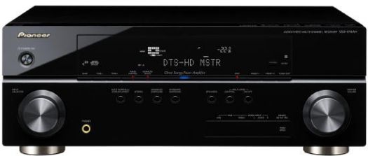

The VSX-919AH we pulled in for review is not the top of the VSX line, but it’s close. Priced at $399, it’s going head to head against some Sony, Denon, Onkyo and Yamaha products, many with similar feature sets, but the Pioneer includes more of them - a true all-in-one product. The VSX-919 is a 7.1 system that can also be set up as a 5.1 system with a separate 2-channel second zone (for another room or backyard). It’s got three HDMI inputs, analog-to-HDMI transcoding (but no resolution scaling), auto speaker setup and room calibration and a fair selection of audio format decoding. All that is fairly standard at $400.
What makes this product stand out is it’s iPod/iPhone connectivity. While most new receivers are compatible with iPhone docking systems, all sold separately, the VSX-919AH comes with an iPod cable: it’s ready for your pocket player right out of the box (more on this later). Yamaha charges an extra $99 for its iPod dock as do many other AVR vendors.
Pioneer's VSX-919AH receiver packs a wealth of features into a fairly affordable package.

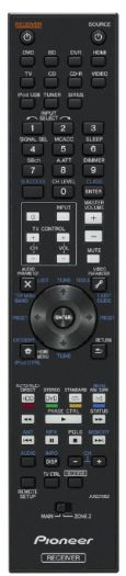

As easy as the receiver is to set up and run, the remote is small, confusing and a bit tedious. It’s covered with tiny print. Most buttons perform multiple functions depending on what mode you’re in, and some related functions are at opposite sides from each other. The most important buttons -- master volume up and down -- are barely any larger than the rest of the buttons.
The VSX-919AH remote includes dedicated iPod and zone 2 controls.

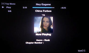

As I pointed out earlier, this receiver is ready and willing to mate with your iPod or iPhone right out of the box. To do so, it comes with a USB input and a USB iPod cable. It’s not as attractive as a dock, but it serves the same purpose. This system offers the best iPod on-screen interface I’ve seen for such a bargain price. You get complete control of your digital library on-screen through the remote (which includes a subset of iPod controls), though scanning through your artists and tracks is a bit slow.
While playing back tracks from your iPod, song information, including album art, is displayed on your TV.
I connected my older iPod Video, pressed the iPod button on the remote and was quickly able to pull up some tracks to sample. The VSX-919AH serves up a pretty sweet iPod GUI with artist/track name and album art. Videos would not play on the big screen from my particular iPod (perhaps because of its age), though the manual states that videos should be playable from newer iPods/iPhones.
That minor quibble aside aside, the iPod connection worked very well. Pioneer has built in some proprietary sound modes to enhance compressed digital music, and they do seem to work well in softening the edge on compressed music files. My lossy iTunes versions of Hey Eugene by China Forbes sounded airy and crisp while Black Sabbath’s Iron Man had plenty of stomp to it.  And for iPhone users, the VSX-919AH will automatically mute A/V playback if a call comes in.
