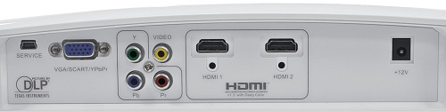

Connection options on the HD20 are surprisingly good. For $999, I wouldn't be surprised to see one HDMI input and little else. Instead you get two HDMI inputs, a component video input plus composite, VGA and a 12v trigger. I used Monster component video cables to connect my Panasonic RP91 for HQV Benchmark testing and a BetterCables HDMI cable from my Panasonic DMP-BD35 for Blu-ray evaluation. One thing I noticed is that the HD20 never stops trying to find a source signal; it constantly cycles through its inputs searching for video. In the setup menu, you can check or un-check the inputs you plan on using. After making those selections the HD20 will limit its search to only those inputs you checked off.

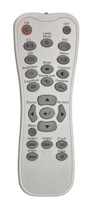

Holy blue buttons, Batman! In addition to taking home the Best Value trophy, the HD20 also receives the award for Brightest Remote Control. Ever. I often knock manufacturers for skipping the remote backlighting to save a few bucks, but I never thought I'd have to go the other way. The HD20 remote is too bright - much too bright. Buttons glow with a blinding blue light and it takes a moment to adjust to it when you're in a darkened home theater such as mine. Making matters worse is the fact that button labels are not backlit. Instead the buttons feature icons, only half of which make obvious sense in the dark. Apart from its cryptic iconography and retina-searing powers of illumination, the HD20's remote is perfectly adequate with a solid cursor pad layout and one-button access to each input.
The HD20 features dual HDMI inputs, component video plus VGA and a 12v trigger.

Shield your eyes! This backlit remote emits some blue rays of its own.
